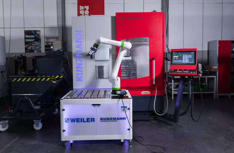

The company selected a FANUC CRX-10𝑖A/L collaborative robot (cobot) with 10 kg payload and 1,418 mm reach. The control-independent robot integrates easily with the multi-vendor CNC systems available for use on the company’s machine tools. Programming takes place via the FANUC Tablet Teach Pendant using intuitive drag-and-drop functions, allowing trainees and operators to learn and deploy robotic tasks quickly.

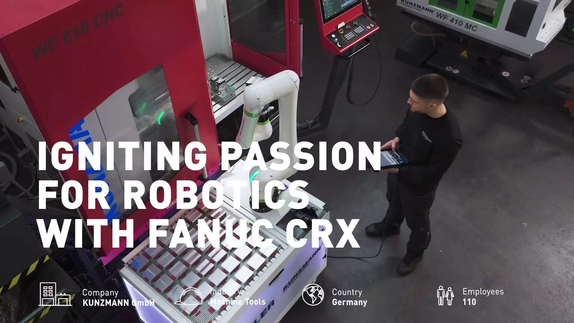

For KUNZMANN Maschinenbau, the introduction of robotics was driven by both practical and educational goals. The German machine tool manufacturer wanted to demonstrate modern automation capabilities while providing trainees with direct exposure to industrial robotics.
“Our main focus is on the design and manufacture of hybrid milling machines, which users can operate using either CNC controls or manually with hand wheels,” explains Niklas Bitzer, Application Engineer at KUNZMANN. “Although production is a core activity, a large part of our remit centres on training.”
With robotics playing an increasingly vital role in manufacturing and the skills shortage proving particularly acute across Europe, the company looked to integrate automation technology into its training environment.
“We wanted a robot because it would not only demonstrate our prowess in this technology, but also because working with robots is fascinating for trainees,” he says. “Unfortunately, we soon hit a hurdle, discovering that many solutions on the market were just too complex.”

Fortunately, KUNZMANN’s ongoing search led the company to the FANUC CRX collaborative robot series, and specifically the CRX-10iA/L model. With a payload of 10 kg and reach of 1,418 mm, the robot offers flexibility for a wide range of automation tasks while remaining straightforward to deploy. Another key factor for Bitzer was compatibility.
“The CRX is control-independent, which means it can connect with any of the control systems we offer for use on our machines, supporting simple integration.”

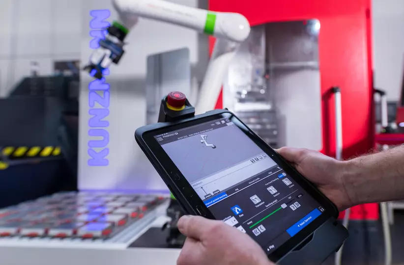

Ease of use proved a decisive advantage. The CRX series takes advantage of the FANUC Tablet Teach Pendant, which features an intuitive drag-and-drop programming interface. Instead of writing complex code, users guide the robot manually and save positions directly on the touchscreen.
Kunzmann Case Study pictures: the machine tools builder introduced a FANUC CRX collaborative robot to facilitate both training and production activities
It’s very easy to learn. We don’t need to have knowledge of any programming languages. Everything is operated by touch using the tablet interface, supporting the simple incorporation of movements into our workflow
