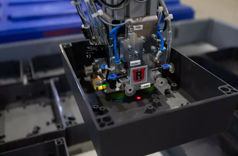

Close‑up of the FANUC robot performing order picking: the advanced end‑effector secures components with precision, enabling seamless integration into the automated assembly process.
Two FANUC M-710𝑖C/45M robots at Hörmann’s Salzkotten factory take parts from prepared large load carriers from a total of 14 spaces. They are then laid on workpiece carriers. Handling reusable packaging and preparing it to ensure it can be returned is also part of the task. It is possible to select manual or automated supply and disposal of order picking.
14 places means that the robots have long paths. Therefore, both FANUC robots have been assembled on a 13 metre long linear axis. Robot 1 approaches spaces 1 to 7, robot 2 approaches spaces 8 to 14. So long as the robots do not travel beyond their respective borders, “Dual Check Safety” (DCS) software offers sufficient protection. Another safety option from FANUC, “Interference Check”, prevents the robots from colliding with one another in dynamic operation.

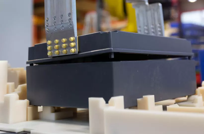

The FANUC robot’s gripper executes precise picking and placement tasks, guided by 3D vision for maximum accuracy. Each movement ensures reliable handling of components and consistent assembly quality.
