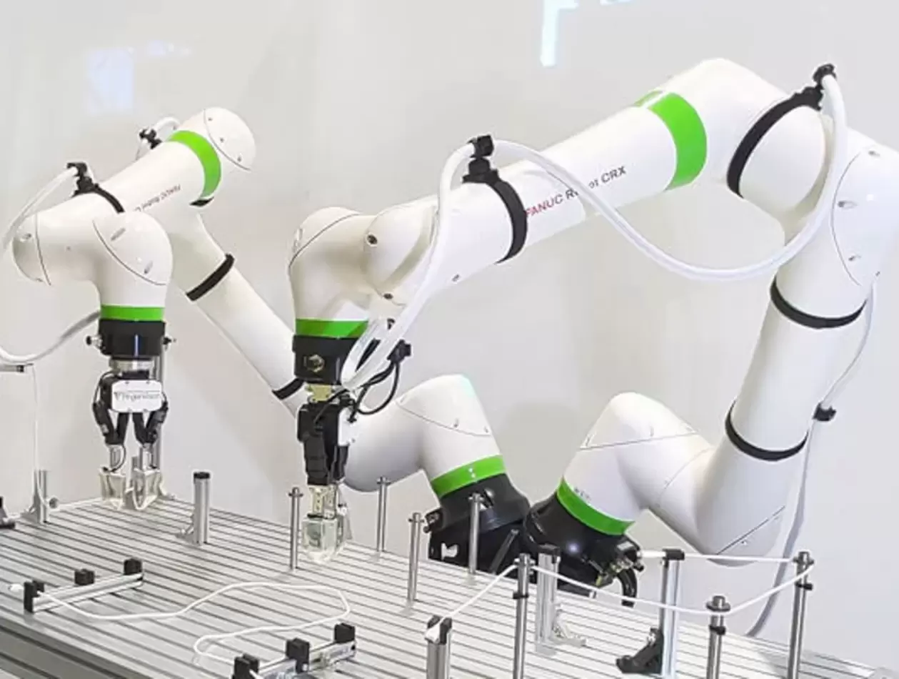

AI Controls Dual Arms to Install a Flexible Cable
Using Vision-Language-Action (VLA) foundation model, two FANUC robot arms can work together to imitate human tasks, like folding a t-shirt or performing highly dexterous wiring operations. The system detects cable tension in real time and manipulates soft, flexible cables with human-like sensitivity. Leveraging multi-axis articulation, the robots route cables across complex 3D paths, including height, depth, and tilt, while maintaining accurate handling and preventing damage.
