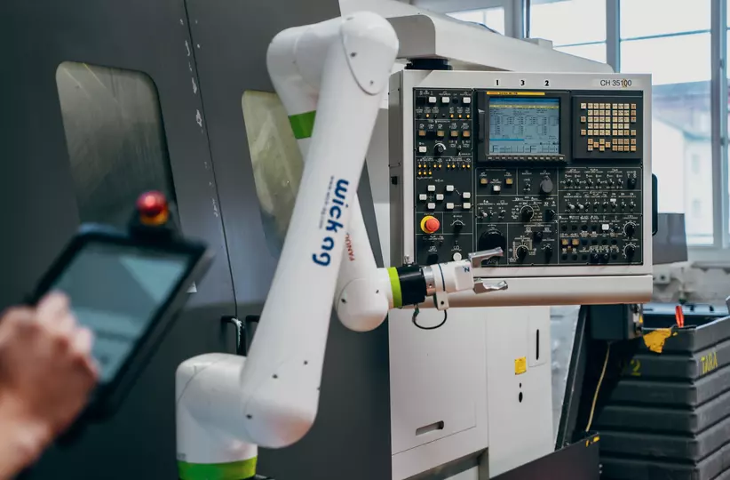

The existing portal automation solution on the CNC lathe was defective. Therefore, an immediately available and simple installable solution was sought.
Solution
With the Wick Slim Cell, which houses a FANUC CRX collaborative robot (cobot), an excellent solution was found with low space requirements and installation effort. In addition, the simple programming of the new CRX convinced the customer.
Result
The CRX automates the unloading of finished parts directly from the lathe and of residual parts from the bar feeder. Machine availability has been increased to 96% per day and productivity has been increased as a complete ghost shift can now be run.

As a collaborative robot, the FANUC CRX-10𝑖A/L does not require any elaborate safety devices, which ultimately has a positive effect on its footprint. Fully complying with the safety standards according to ISO 10218-1 its sensitive sensors trigger an immediate safety stop if it touches an obstacle. The anti-trap protection and the soft rubber skin that partially covers the cobot also ensure that the machine operators feel safe and can work in close contact with their robot colleague without fear.

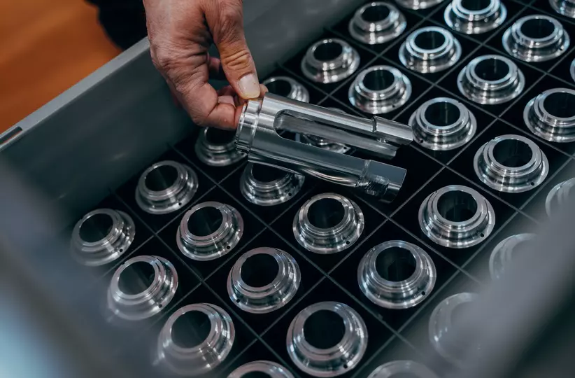

The FANUC cobot unloads finished parts from the Nakamura WTS-150 and removes remnants from the bar feeder. It can even perform an unmanned ghost shift. Thanks to the high process stability, the daily availability of the lathe was increased to up to 96 percent.

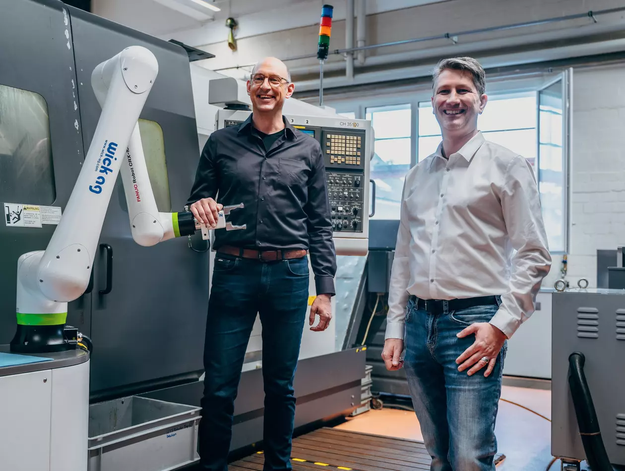

The installation of the cobot and the initial programming of the tasks to be performed were carried out by experienced technicians from Wick AG. The system house from Küssnacht in Switzerland has been developing automation solutions for small and medium-sized companies for around 20 years.
Finished parts for pressing tools, unloaded from the lathe with a FANUC CRX cobot at Emerson Professional Tools AG.
Guido Lüönd, CTO of Wick AG, is particularly enthusiastic about the ease of installation of the new CRX series: "Thanks to its lightweight, compact design, the FANUC CRX-10𝑖A/L can be easily integrated into any work area or existing systems. We don't need a crane or any other lifting device." The new, particularly compact R-30𝑖B Mini Plus controller also fits in perfectly.
The automation expert is also impressed by the convenient programming options: "The FANUC CRX-10𝑖A/L enables Manual Guided Teaching. This means that the robot can easily be guided by hand to the desired positions, which can be saved on the tablet using the drag & drop function. This way, a new application is programmed in just a few minutes.”
