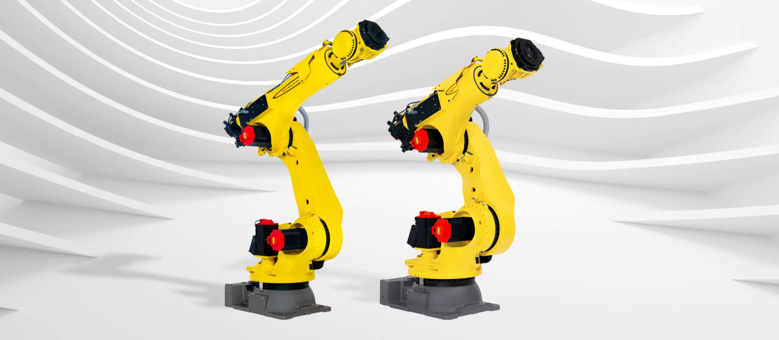

FANUC is expanding its machining robot portfolio with the new M-810 series, designed to help manufacturers machine large metal components more flexibly and cost-effectively. By combining high stiffness with advanced accuracy control as standard, the new series enables applications such as milling, drilling and deburring to be performed by a robot, reducing reliance on large, capital-intensive CNC machine tools.
FANUC M-810 Series
M-810/190-20B and M-810/270-27B
Comprising two models, the M‑810/270-27B (270 kg payload) and the M‑810/190-20B (190 kg payload), the M-810 series delivers significantly enhanced machining capability for demanding applications. The M-810/270-27B offers a payload of 270 kg and a reach of 2.7 m, providing a larger operating space and substantially higher machining load compared with previous models.
This performance enables manufacturers to machine large or complex components more effectively, supporting industries such as automotive, aerospace and general manufacturing where part size and flexibility are critical considerations.
