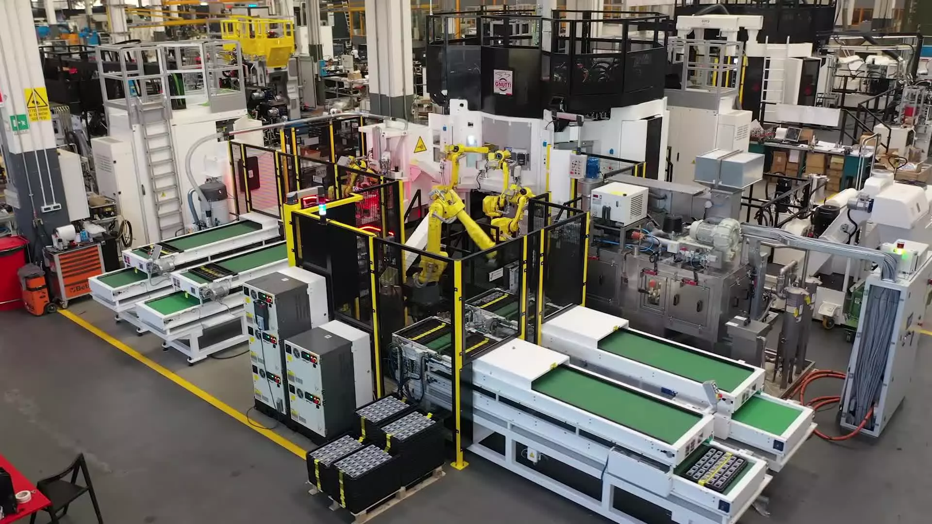

At the start of the process, loading is via the automatic recognition, division and control of cassette parts, before each component passes through a control station for laser marking. The transfer machine then performs machining operations prior to extraction for washing. After washing to remove any residue, the system returns parts to the cassette.

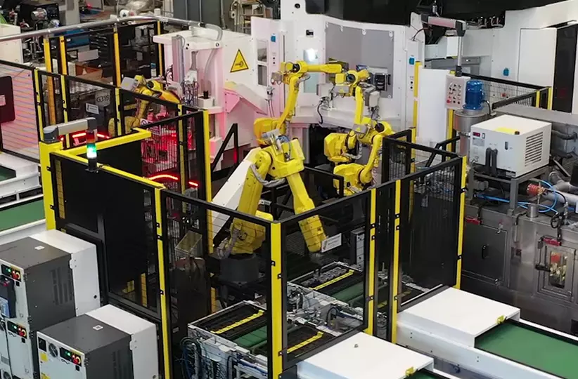

Robots are present at all stages: a robot equipped with a vision system removes raw parts from the cassette and places them on a conveyor belt that feeds the laser machine for marking; a second robot then loads the components into the transfer machine before a third robot unloads the machine and places the parts in an intermediate station. A fourth robot loads the components into the washer; and finally, a fifth robot takes the parts from the washer and places them back in the cassette, ready for automatic relay to assembly.

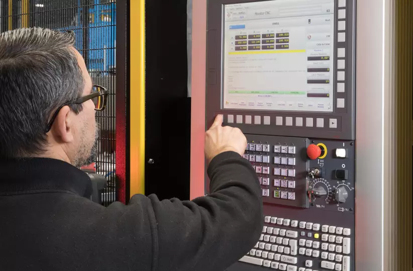

The unit is Industry 4.0-certified: the chucks and all parts are fitted with sensors that analyse the data relating to the unit's functionality. An industrial PC is completely dedicated to managing the machine and controlling more than 12,000 variables, which enables the customisation of functionality that ranges from preventive/predictive maintenance to regulating process parameters. The customer can log in remotely, supervise the machine, start cycles and amend the entire system’s configuration to execute various types of processing.
