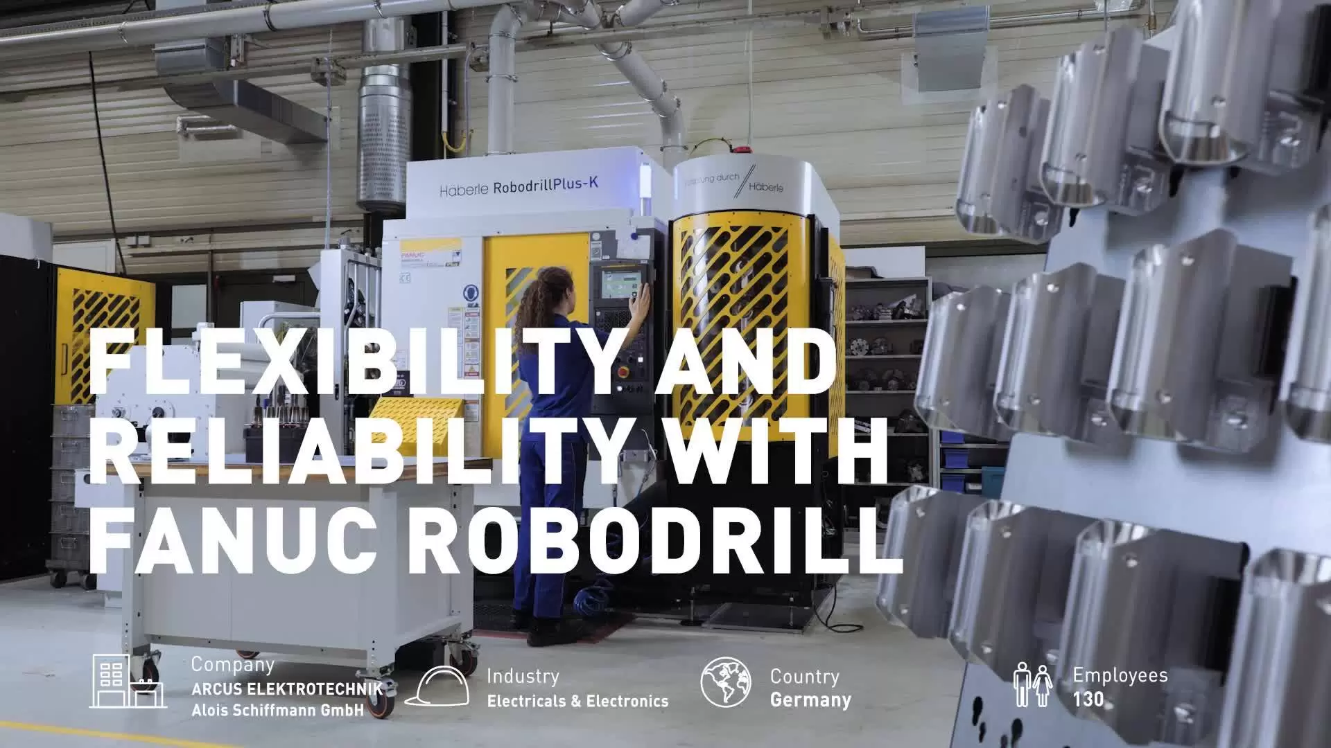

ARCUS ELEKTROTECHNIK is using a FANUC ROBODRILL Plus-K automated machining cell to manufacture complex, high-precision energy sector components economically from batch sizes as small as one. Combining a FANUC ROBODRILL 𝛼-D21M𝑖B5 ADV Plus CNC machining centre with integrated tool and workpiece handling via a FANUC LR Mate 200𝑖D robot, the solution enables flexible, unmanned production with rapid changeovers and minimal downtime.

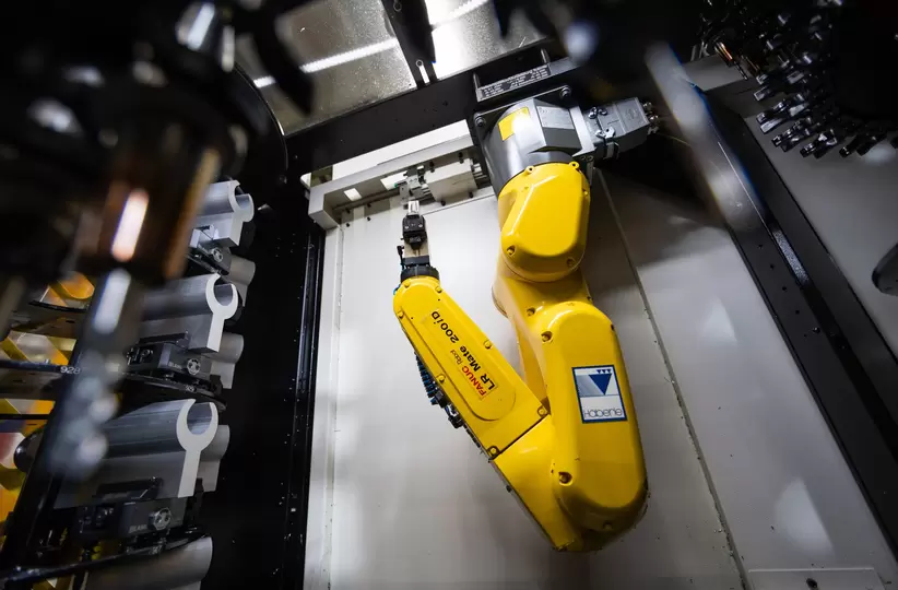

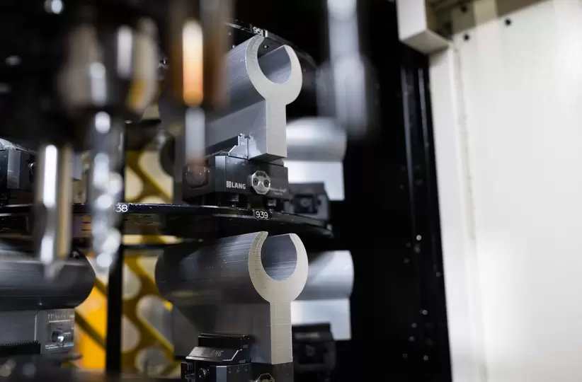

The ROBODRILL Plus-K addresses this requirement by automating both workpiece and tool handling. Its integrated FANUC LR Mate 200𝑖D robot has a 7 kg payload and 717 mm reach, while the cell's storage system accommodates up to 65 tools and 60 workpiece pallets. This capability means ARCUS can operate economically from batch size one, with the cell able to switch between different parts automatically.
“It can change over to a new component on its own, unmanned, during the night shift, for example,” points out Lutzny. “By the next day, various orders have been processed and we can deliver to customers quickly.”
The compact, self-contained system also simplifies operation, with pallet management and program assignment handled directly through the FANUC 31𝑖-Model B5 Plus control.
