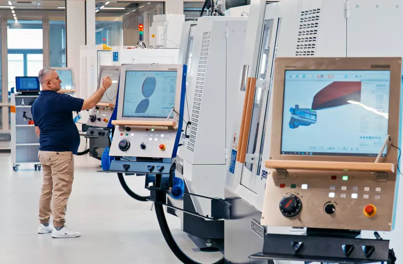

The solution supplied to SCHNEEBERGER today is based on a FANUC 31𝑖-B CNC with FANUC PANEL 𝑖H Pro industrial PC. Thanks to the use of FANUC I/O Link𝑖, the CNC and FANUC robots communicate via a single control platform.
“For us, connection between the robot and CNC is a great advantage,” declares Antonio Grasso, Head of Electronic Development at SCHNEEBERGER. “It means that our users can monitor two completely different systems with one control. What’s more, our adoption of the latest 31-𝑖B control means we now have a CNC with even better diagnostics capabilities, thus enhancing machine reliability.”

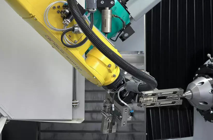

Automated CNC grinding with FANUC Robot LR Mate 200iD at CNC tool‑grinding machine manufacturer SCHNEEBERGER Maschinen AG.
